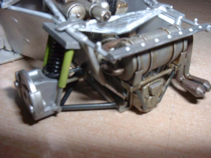

[AUTO] Delta s4 Rallysport-dscf0001.jpg   [AUTO] Delta s4 Rallysport-dscf0002.jpg   [AUTO] Delta s4 Rallysport-dscf0003.jpg
[AUTO] Delta s4 Rallysport-dscf0004.jpg   [AUTO] Delta s4 Rallysport-dscf0005.jpg   [AUTO] Delta s4 Rallysport-dscf0006.jpg
[AUTO] Delta s4 Rallysport-dscf0007.jpg   [AUTO] Delta s4 Rallysport-dscf0008.jpg   [AUTO] Delta s4 Rallysport-dscf0009.jpg
