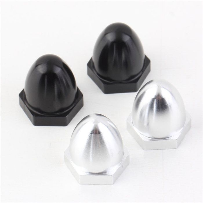

HobbyKing Slowfly Propeller 10x4.5 Black (CW/CCW) (4pcs) (EU Warehouse)
Servono anche questi, però!
http://www.dhresource.com/0x0s/f2-al...cap-sleeve.jpg
