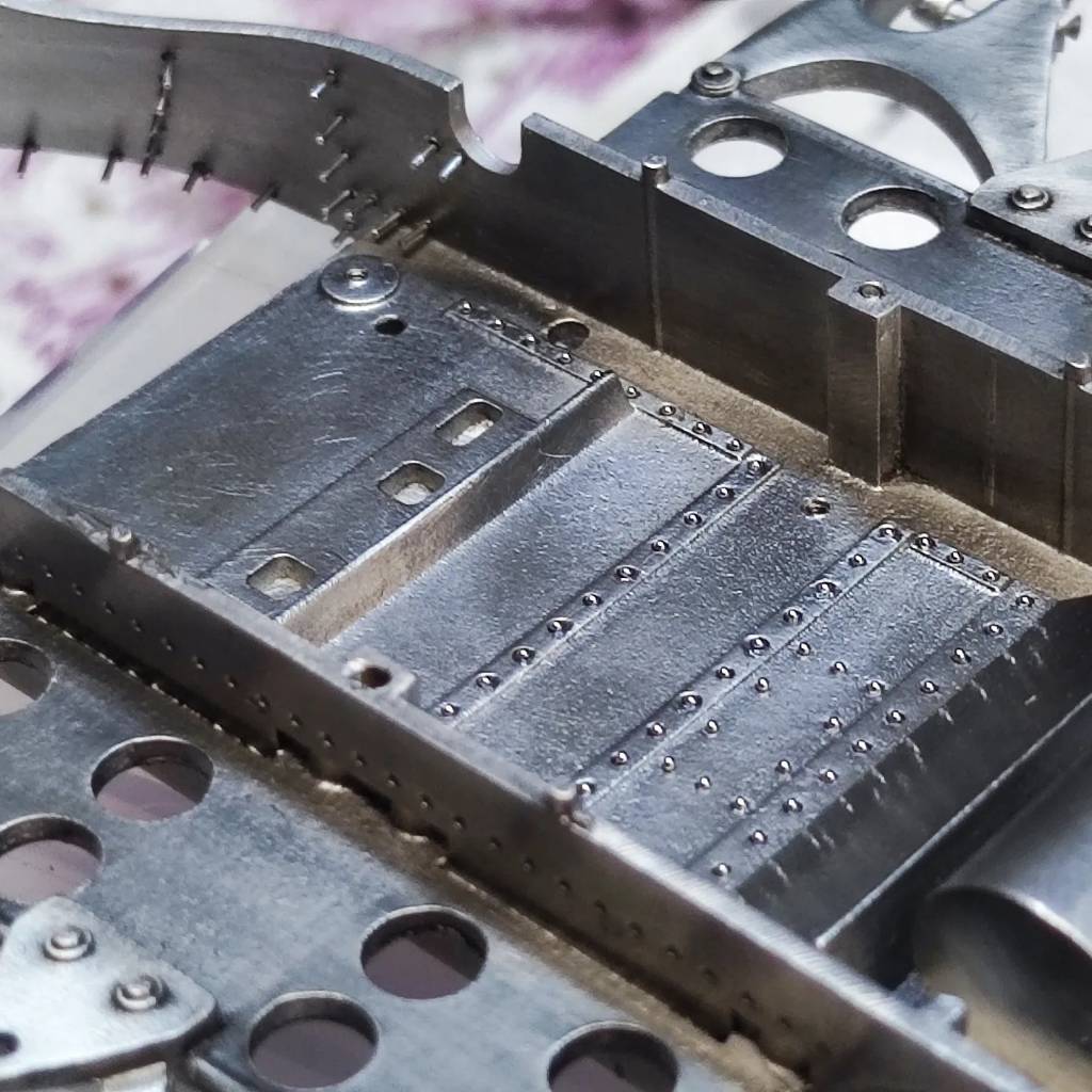

Metto giusto un paio di rivetti. Per le parti meno in vista ho usato le palline per saldatura da 0.6 mm. Per l'esterno più in vista i rivetti di Hiro da 0.8.Tyrrell P34/2 Model Factory Hiro 1/12-img_20230126_000237_262.jpgTyrrell P34/2 Model Factory Hiro 1/12-img_20230126_000237_333.jpgTyrrell P34/2 Model Factory Hiro 1/12-img_20230126_000237_361.jpgTyrrell P34/2 Model Factory Hiro 1/12-img_20230126_000237_417.jpgTyrrell P34/2 Model Factory Hiro 1/12-img_20230126_000237_430.jpgTyrrell P34/2 Model Factory Hiro 1/12-img_20230126_000237_465.jpgTyrrell P34/2 Model Factory Hiro 1/12-img_20230126_000237_483.jpgTyrrell P34/2 Model Factory Hiro 1/12-img_20230126_000237_507.jpgTyrrell P34/2 Model Factory Hiro 1/12-img_20230126_000237_522.jpgTyrrell P34/2 Model Factory Hiro 1/12-img_20230126_000237_530.jpg
Inviato con il mio 2109119DG - Scarica l‘app del Forum di Modellismo.net
