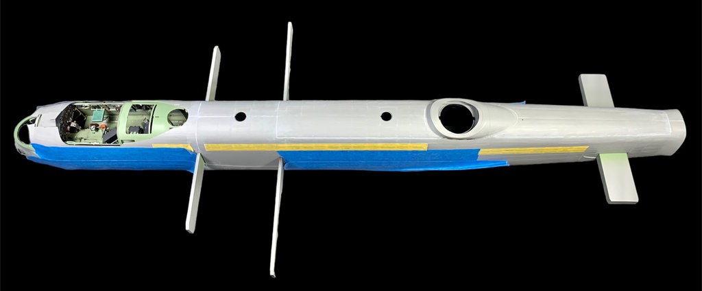

Date un ultimo saluto a tutta la baracca, sto per chiudere il salamone Avro Lancaster 1/32 border model-photoroom_20230225_173840.jpgAvro Lancaster 1/32 border model-photoroom_20230225_174102.jpg

Chiuso il salamoneAvro Lancaster 1/32 border model-photoroom_20230305_195832.jpgAvro Lancaster 1/32 border model-photoroom_20230305_195814.jpgAvro Lancaster 1/32 border model-photoroom_20230305_195753.jpgAvro Lancaster 1/32 border model-photoroom_20230305_195733.jpgAvro Lancaster 1/32 border model-photoroom_20230305_191859.jpgAvro Lancaster 1/32 border model-photoroom_20230305_191801.jpgAvro Lancaster 1/32 border model-img_6918.jpgAvro Lancaster 1/32 border model-img_6925.jpg
