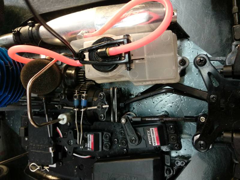

Vecchio 28-02-20, 01:08 PM   #22
Delucchi.
