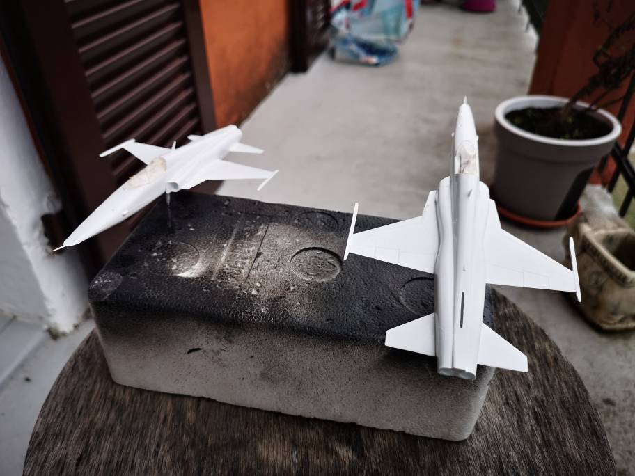

Nel frattempo ho trovato di tondini di plexi ed effettuata una prova di "piega" [Aerei] F-5E Tiger II Patrouille Suisse 1/72-img_20200103_165720.jpg[Aerei] F-5E Tiger II Patrouille Suisse 1/72-img_20200103_165712.jpg[Aerei] F-5E Tiger II Patrouille Suisse 1/72-img_20200103_155249.jpg[Aerei] F-5E Tiger II Patrouille Suisse 1/72-img-20191225-wa0011.jpg[Aerei] F-5E Tiger II Patrouille Suisse 1/72-img_20191227_220454.jpg[Aerei] F-5E Tiger II Patrouille Suisse 1/72-img_20191227_220532.jpg[Aerei] F-5E Tiger II Patrouille Suisse 1/72-img_20191224_083252.jpg[Aerei] F-5E Tiger II Patrouille Suisse 1/72-img_20191229_170021.jpg[Aerei] F-5E Tiger II Patrouille Suisse 1/72-img_20191229_041857.jpg

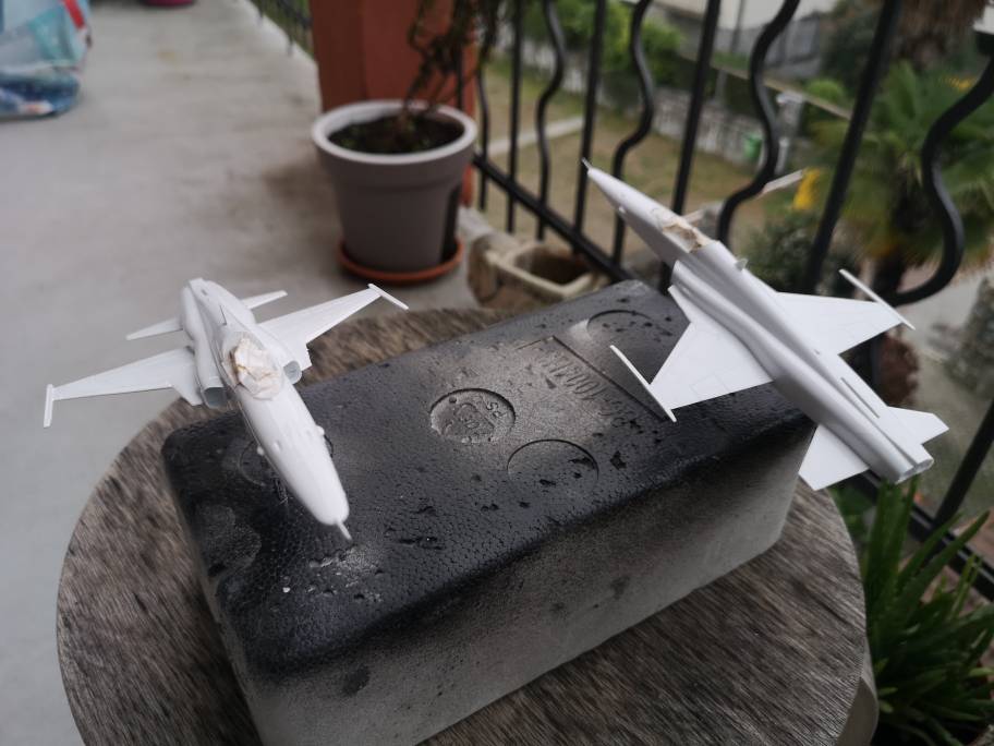

Per il momento ho fatto una prima prova di posizionamento "al volo".[Aerei] F-5E Tiger II Patrouille Suisse 1/72-img_20200114_220747.jpg[Aerei] F-5E Tiger II Patrouille Suisse 1/72-img_20200114_220807.jpg[Aerei] F-5E Tiger II Patrouille Suisse 1/72-img_20200114_220827.jpg[Aerei] F-5E Tiger II Patrouille Suisse 1/72-img_20200114_220858.jpg[Aerei] F-5E Tiger II Patrouille Suisse 1/72-img_20200114_220927.jpg
