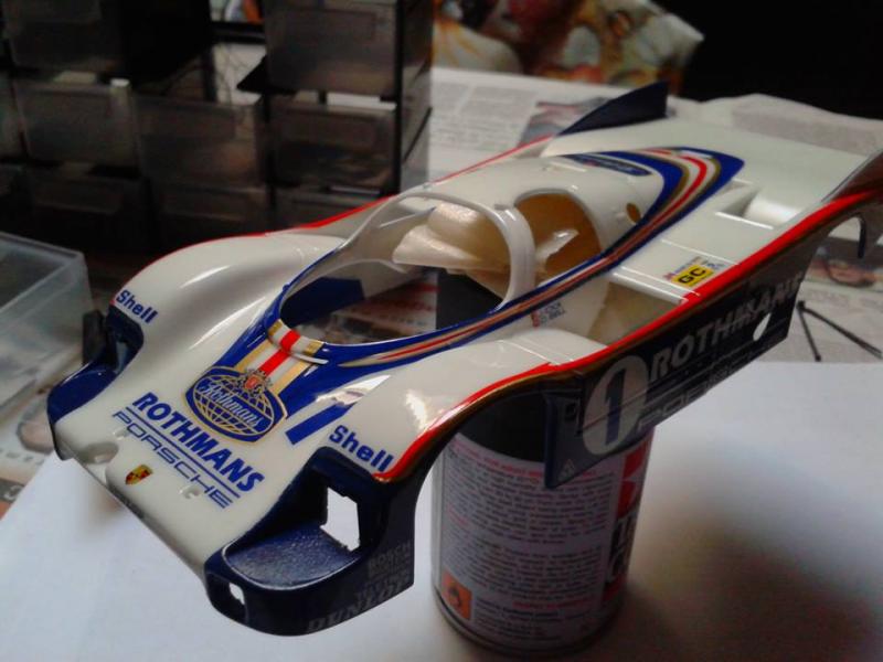

Lavoro ultimato
Tamiya Porsche 956 le mans winner 1982-2013-09-06-20.10.01.jpg   Tamiya Porsche 956 le mans winner 1982-2013-09-06-20.09.37.jpg   Tamiya Porsche 956 le mans winner 1982-2013-09-06-20.10.18.jpg
Tamiya Porsche 956 le mans winner 1982-2013-09-06-20.12.08.jpg   Tamiya Porsche 956 le mans winner 1982-2013-09-06-20.11.54.jpg   Tamiya Porsche 956 le mans winner 1982-2013-09-06-20.07.12.jpg
Tamiya Porsche 956 le mans winner 1982-2013-09-06-20.13.21.jpg   Tamiya Porsche 956 le mans winner 1982-2013-09-06-20.07.51.jpg   Tamiya Porsche 956 le mans winner 1982-2013-09-06-20.08.30.jpg
