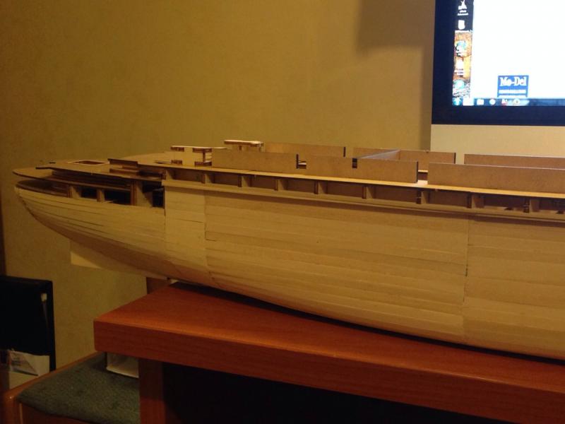

Andrea doria primo cantiere-imageuploadedbyforum1389897464.049610.jpgAndrea doria primo cantiere-imageuploadedbyforum1389897474.717545.jpgAndrea doria primo cantiere-imageuploadedbyforum1389897485.483414.jpgAndrea doria primo cantiere-imageuploadedbyforum1389897494.849165.jpgAndrea doria primo cantiere-imageuploadedbyforum1389897503.999880.jpgAndrea doria primo cantiere-imageuploadedbyforum1389897514.333391.jpgAndrea doria primo cantiere-imageuploadedbyforum1389897524.099987.jpgAndrea doria primo cantiere-imageuploadedbyforum1389897537.783803.jpgAndrea doria primo cantiere-imageuploadedbyforum1389897548.766045.jpg
