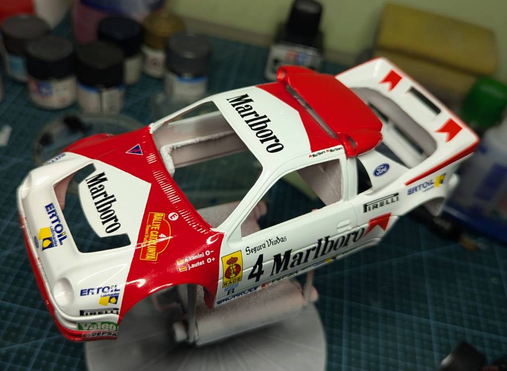

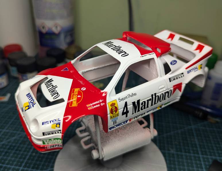

Livrea vietata ai minori Ford Rs200 Rally Cataluņa 1986-pxl_20250201_120417542.jpgFord Rs200 Rally Cataluņa 1986-pxl_20250201_120505555.jpgFord Rs200 Rally Cataluņa 1986-pxl_20250201_120447138.jpgFord Rs200 Rally Cataluņa 1986-pxl_20250201_121447001.jpg

Livrea vietata ai minori Allegato 443744Allegato 443745Allegato 443746Allegato 443747
Veramente spettacolare!!
